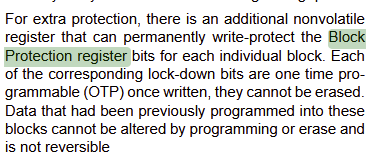

I actually ran into a similar issue but I wasn’t using the iceprog I was using the Diamond programmer from lattice. Here is what I found.
It seems that the SST26VF032B’s Block Protection Register (BPR) is set by the alchitry folks when they send us the devices and their tool unlocks it but the Diamond installer doesn’t. Once it has been unlocked the diamond installer works just fine. It almost seems like they are using a different tool to program the devices in the factory than the Alchitry Labs tool.
