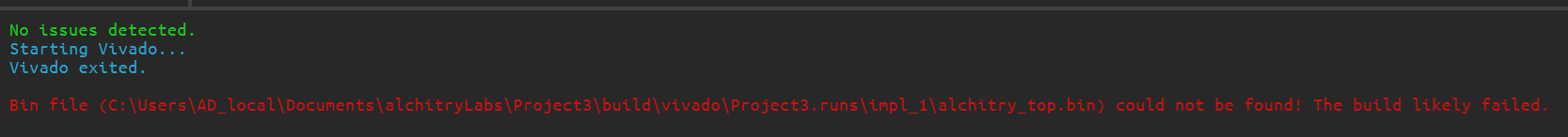

This means your build failed for some reason. Without the build logs, it’s impossible to tell why.

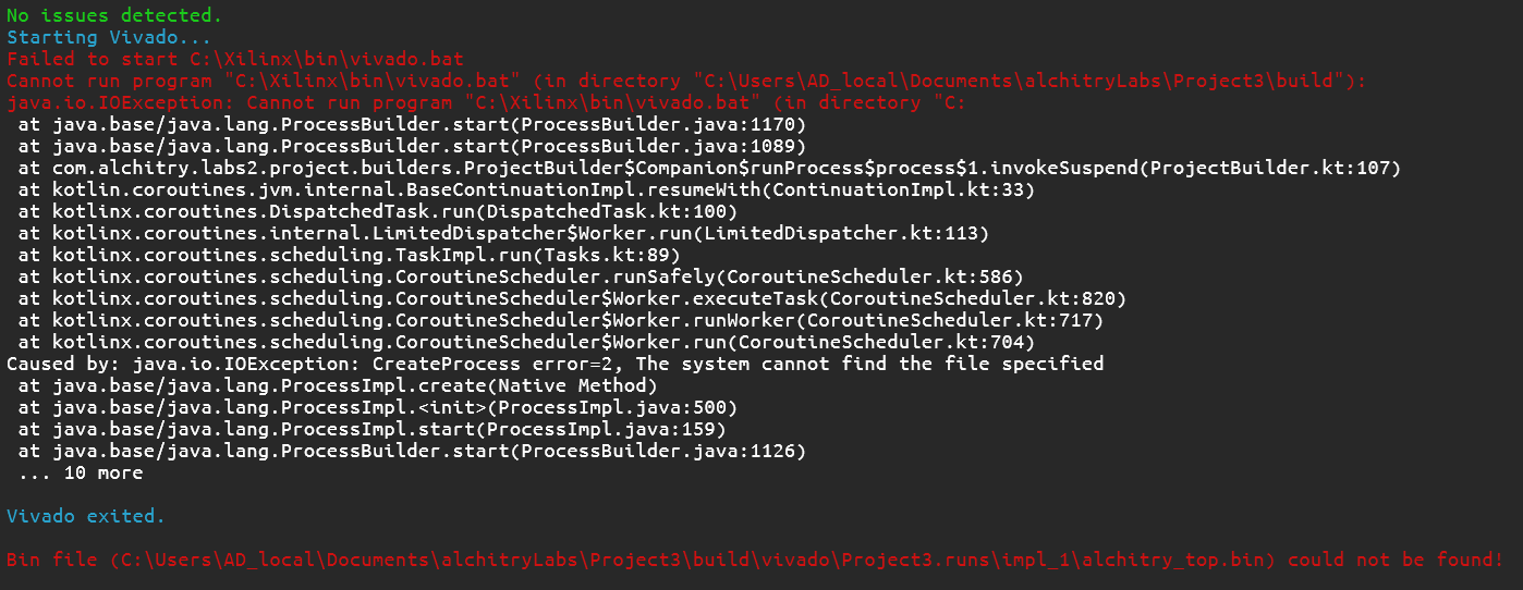

This is the only build log message I see.

It seems like Vivado is crashing. There should be a ton of output between starting Vivado and it exiting. Are you on Windows or Linux?
Make sure you can run Vivado on its own.

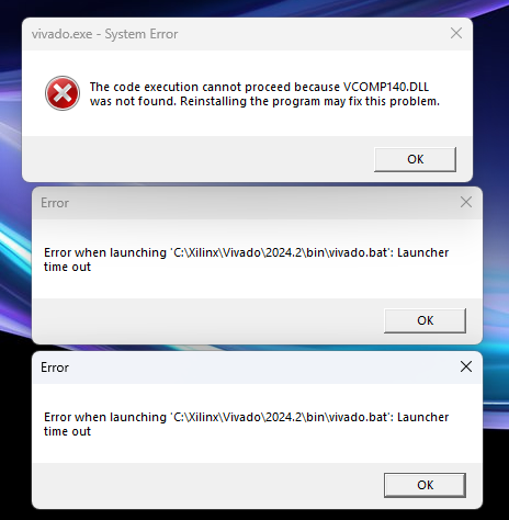

Vivado did run on its own when I installed it (I checked because I was having Vivado problems), but now I am getting *.dll and *.bat file errors as well…

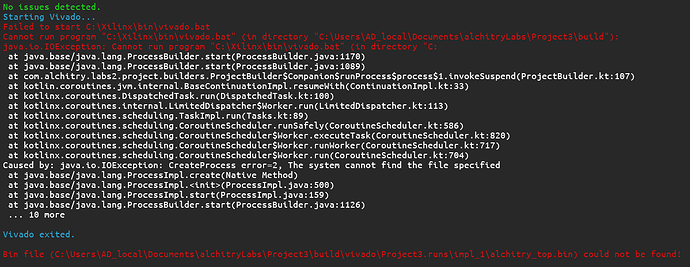

Update: I uninstalled and reinstalled Vivado, which gives the same issue. I did update the Vivado pointer folder to point to the parent Xilinx folder, and then I got some errors in the build log…
The first message sates that you are missing the VS 2015 redistributable package : https://www.microsoft.com/en-us/download/details.aspx?id=48145
Installing this should fix the Vivado issue ![]()
You will also need to rollback the pointer change
