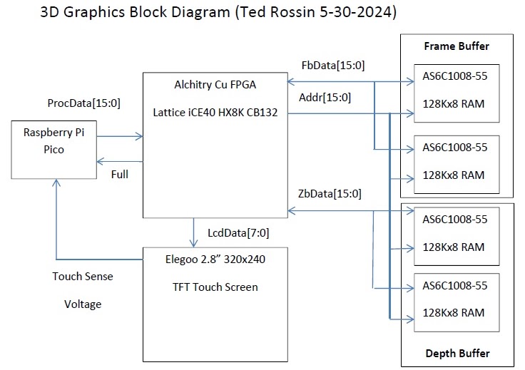

I connected a Raspberry Pi Pico, some RAM and a 320x240 TFT display to create an OpenGL 3D system.
Details with Verilog and test benches can be found here:
Video of the system can be found here:

This is super cool! Thanks for posting about it.
I love the stacked DIP chips. ![]()
